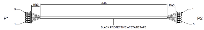

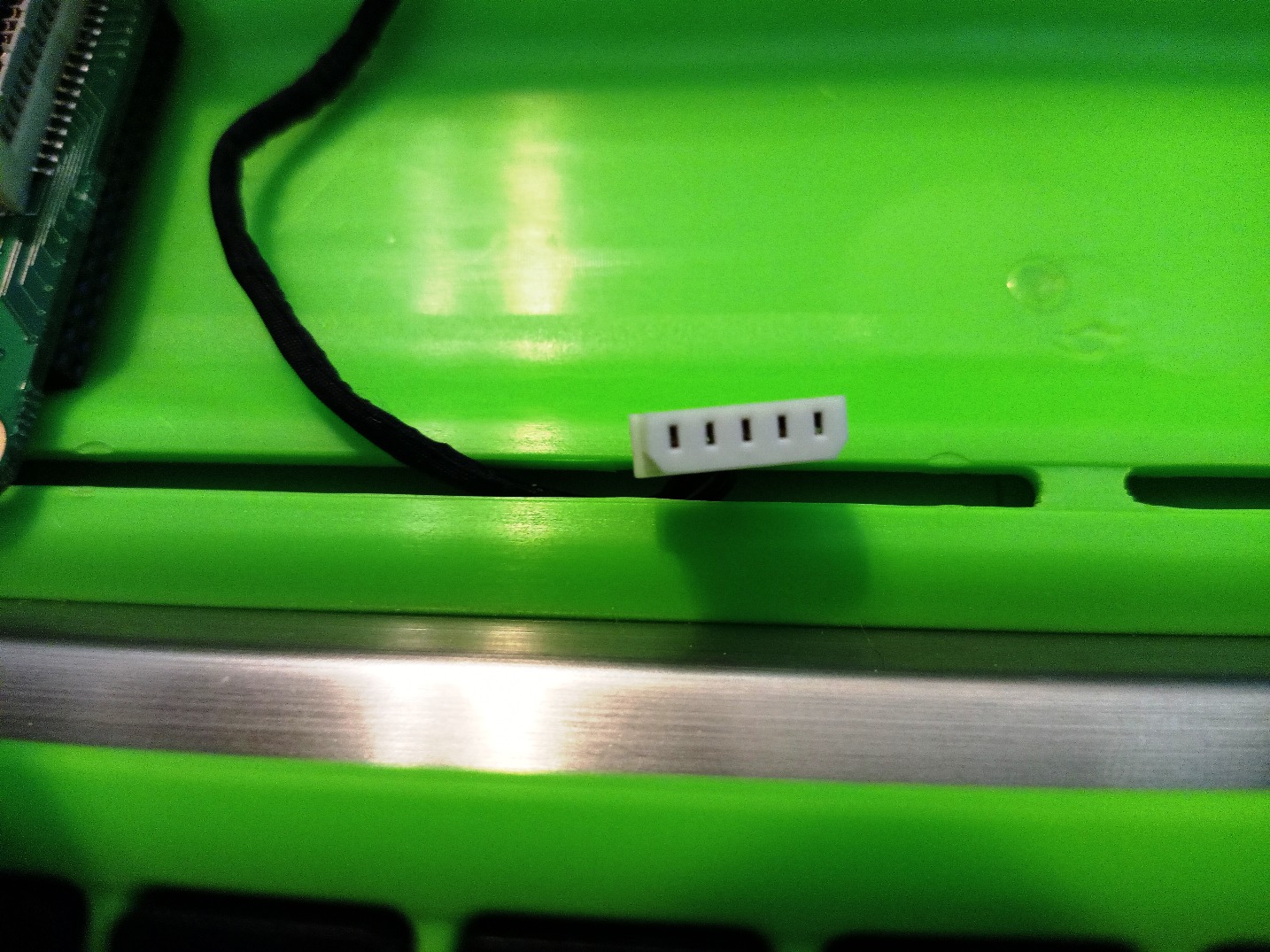

Does anyone know where I can find the connector to build a replacement control power cable for my pi-top 1?
5 pin female connector on both ends looks like this:

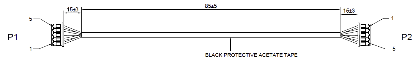

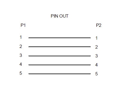

Just be careful about pinouts,. meant to include
Perfect. Thank you! I was wondering if it was straight through or not.
