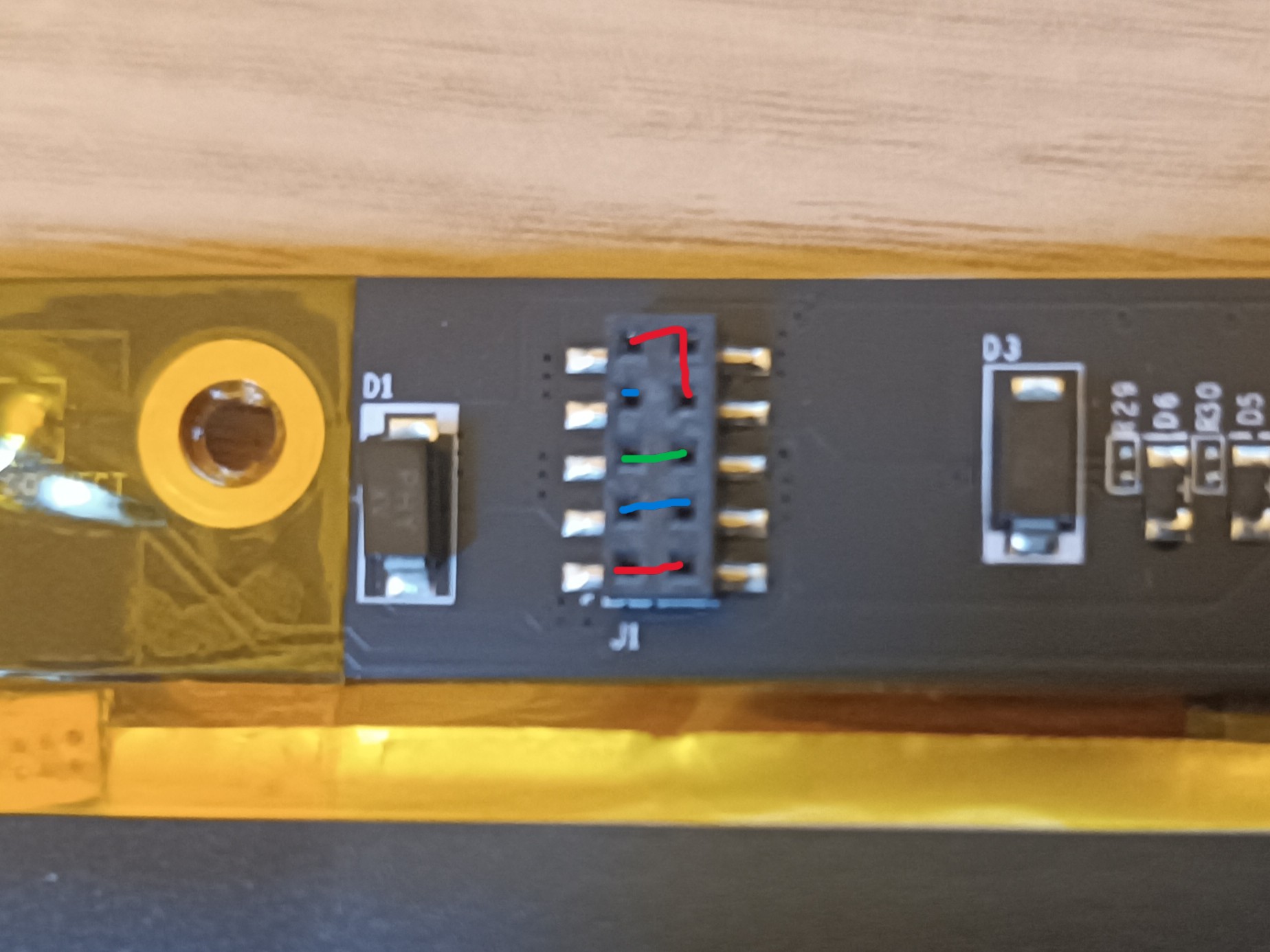

I took apart my pi-top battery to check pinout(for reuse).
BatteryMaybe
1848×1386 301 KB
And after some measurements i came to conclusion that :
RED: +12V (marked pins are shorted)
BLUE: GND (marked pins are shorted)
GREEN: SMBUS
Am I right ?
