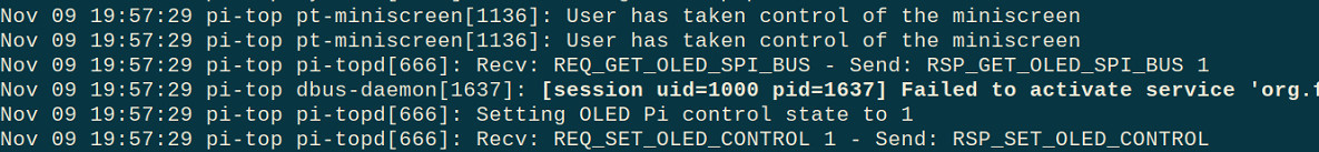

after watching the log files i noticed the command (to open the log run “journalctl -n 100”
Pi-top oled display “hi”
was activating and retruning the following in log files
i noted the SPI was running on 1

3.then flipped the SPI Interface from 1 - 0 using the following command “pi-top oled spi 0”
