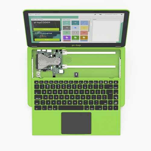

Are you refering to the Pi-top CEED or the pi-top laptop version 2 which is the pi-top[3]?
The product I bought was described as “Pi-Top2 Educationsnotebook mit Raspberry 3+ 14” Display, US-Layout, Inkl.Inventors Kit" (in Switzerland.) It’s definitely a laptop though.
Like this?
Yes. That’s it. Mine also has the speakers and a breakout board.
I see it is, look in the pi-top[3] forum. RPi 4 has some problems due to repositioned USB and Ethernet. Rpi5 has them the same way as the RPi3. Power may be your problem, it will complain that the power supply isn’t compatible, albeit if the “Hub” power capability the same as the Pi-top[1]/Ceed can supply 3.5A max. And the cooling will need to be sorted due to the weird Connector from the Hub to the RPi. Hope that helps?
