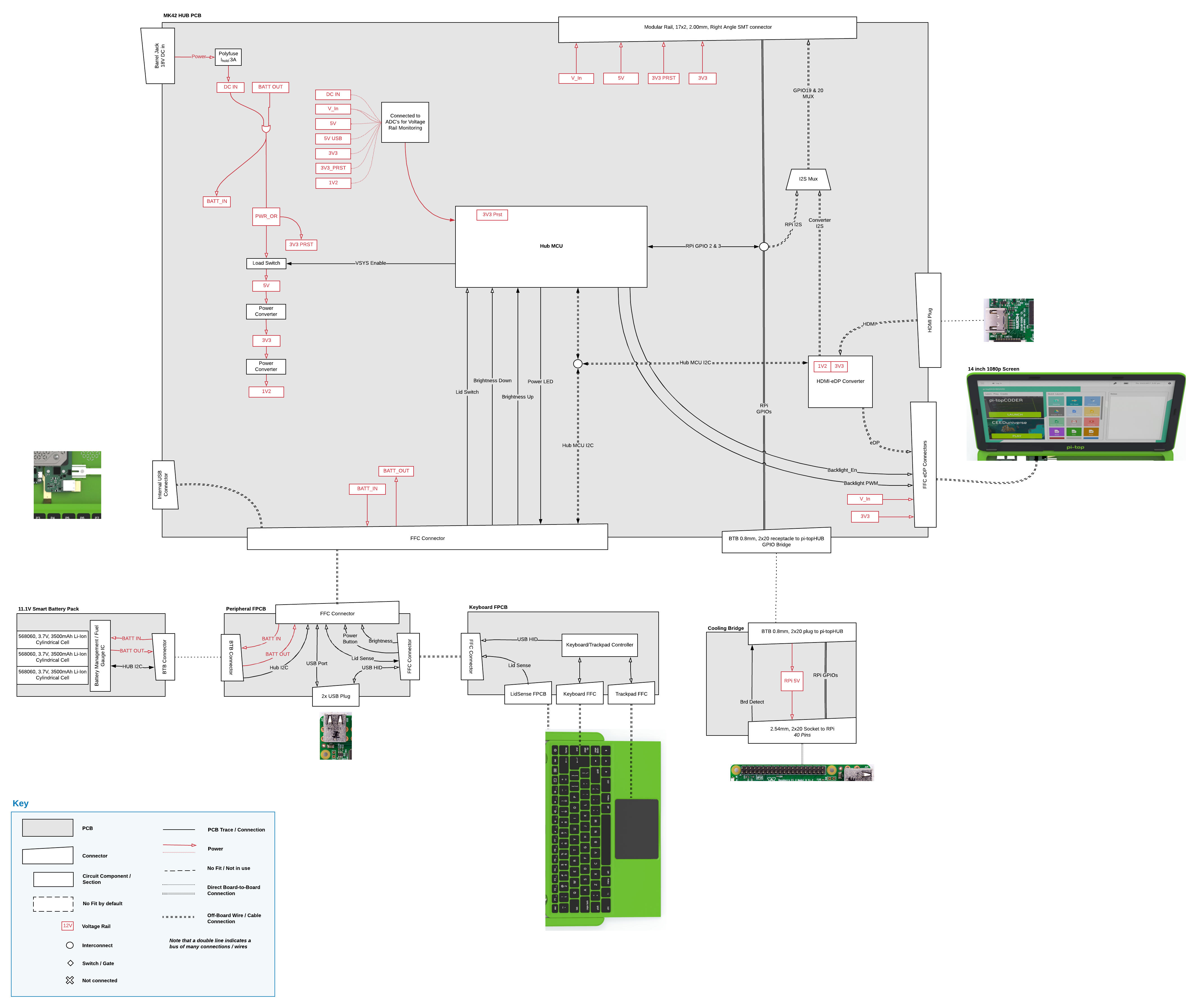

Looking at the block diagram https://forum.pi-top.com/uploads/default/a118e83ce4494e3a7e66591fc13f793eb17eff0e the battery is an 11.1V smart battery which communicates to the hub via I2C.
Sniff the I2C connection, and/or disassemble a dead battery to get to know the management IC. Take an 11.1V setup of your choice, add said IC and you should have your new smart battery.
Note: do at own risk!
