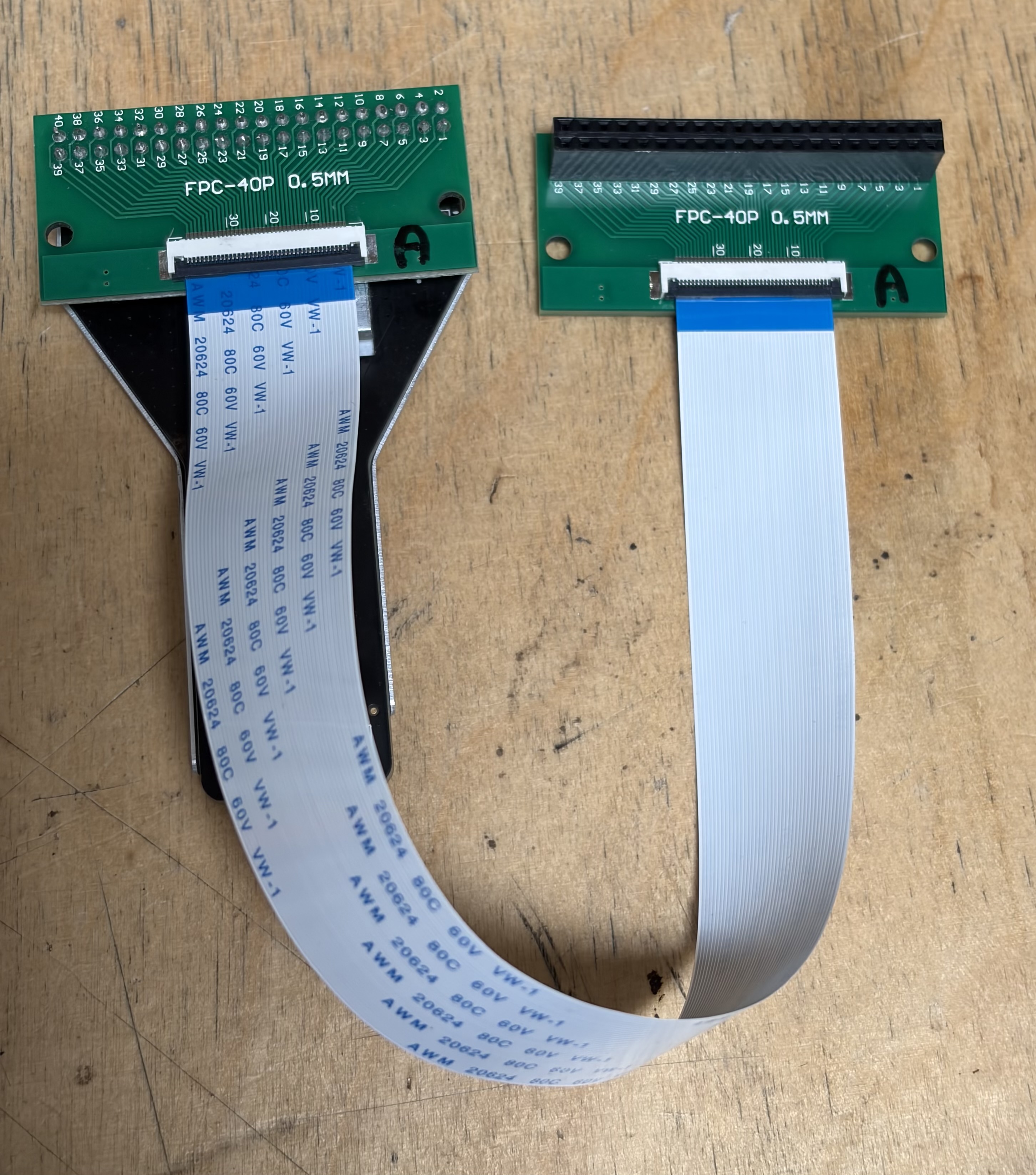

I’ve recently purchased a Pi-Top 3 and have been playing with the idea of fitting a CM5 into the body too. To test the water, I’ve just tried using a Waveshare Mini Base Board (A) for the CM5 and used a FPC 40P adapter for the GPIO and a HDMI DIY adapter from ThePiHut to extend out the HDMI so I can place the CM5 on the rail mount.

Very exciting post! Love the pic. What cable did hyou use to attach the CM5 output to the pitop screen? looks like some kind of a ribbon cable ?
I’m using two of the FPC-40P boards with GPIO pins soldered onto them; you can get them pre-soldered online from a number of online store (ThePiHut, Amazon, etc), but it’s hard to find ones with the correct GPIO pins on the correct sides (female on the top, male on the bottom) so I would recommend getting blank ones and soldering you’re own GPIO pins, like this:
Then it’s a FPC 40 flex cable with a B configuration - I’m using a 25cm version.

Very helpful. Looks like a non-trivial job to get that GPIO ribbon built. I am also curious about your HDMI and USB connectors. Especially that black USB cable in the back left corner of the device where the Pi would normally sit. I assume its a USB-A female to USB-A male? I struggled to find a USB-female with thin enough of a housing to connect to that double USB adapter in the corner of the Pi-top. Where did you find it? And your HDMI looks like some kind of a flat flexible cable too?
