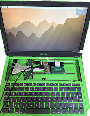

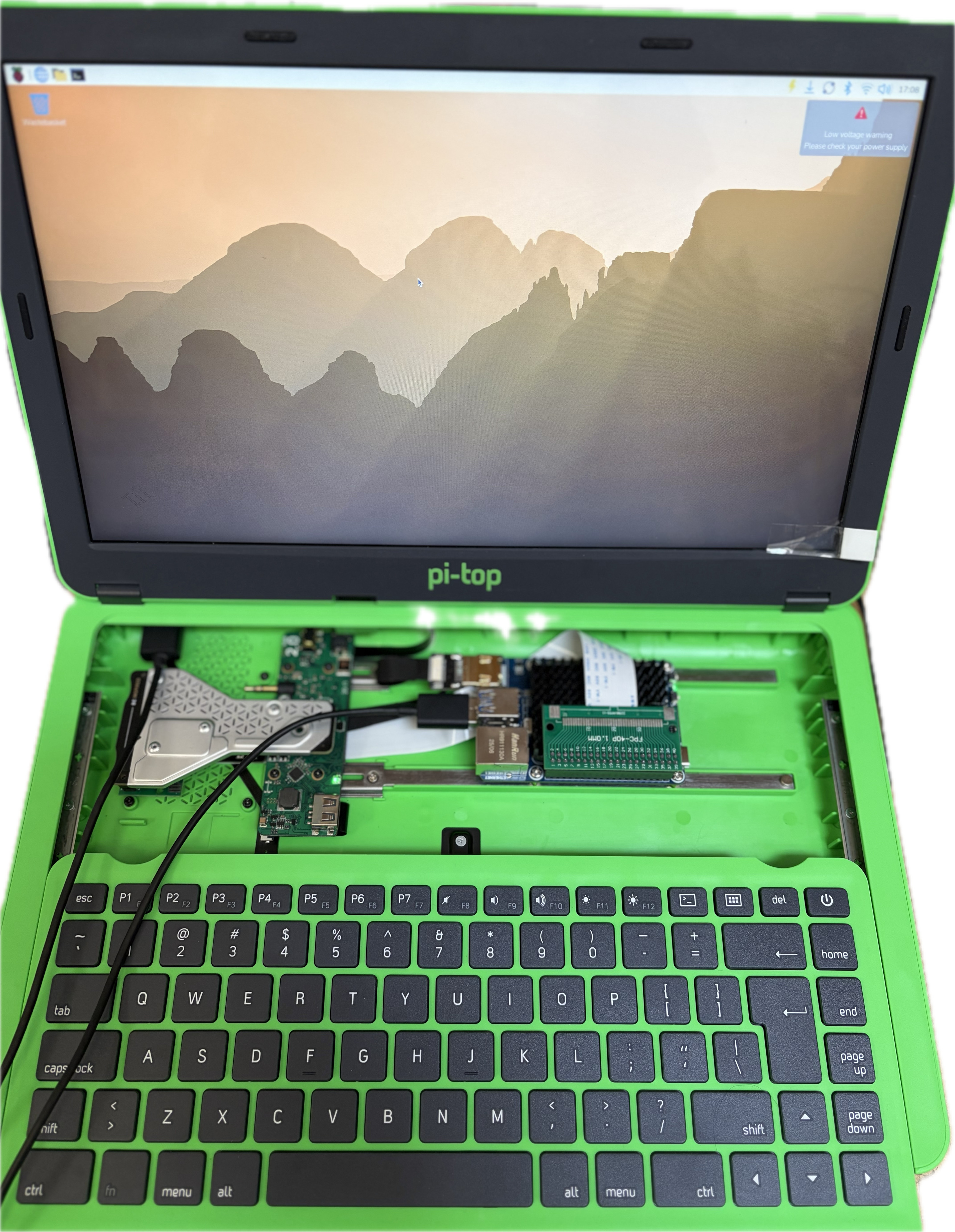

Hey!
I’ve recently purchased a Pi-Top 3 and have been playing with the idea of fitting a CM5 into the body too. To test the water, I’ve just tried using a Waveshare Mini Base Board (A) for the CM5 and used a FPC 40P adapter for the GPIO and a HDMI DIY adapter from ThePiHut to extend out the HDMI so I can place the CM5 on the rail mount.
What excited me (a little odd to say but none the less), I’m just running the normal Raspberry Pi OS on the CM5 (has EMMC memory) and the Brightness controls work!
Just need to configure the Battery monitoring and it’s a working laptop!
Regarding getting this all to fit, I’m thinking of ways to get this board and CM5 to fit above the rails - having the cooling block onto presently is going to hamper getting this all to fit too. Also need to work out a better power solution for the CM5 as it’s complaining about being under voltage so maybe need to see if I can tap off the 18V line somehow and use a buck converter (or equivalent).
Very exciting post! Love the pic. What cable did hyou use to attach the CM5 output to the pitop screen? looks like some kind of a ribbon cable ?
